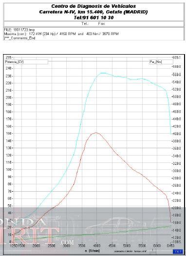

dyno results : 234 hp and 400 nm

hi friends
this is the last dyno result of my thema 16vt serie II (185 hp official :top: ) i just use a manual boost controller to obtain 1.4 b peak turbo pressure, so as you can see with this turbo unit i cant go for more.....well with 234 i can say that im the shadow for my friends that drives s3 chipped of 242 hp and cupra r with 245 hp boths in the same dyno test :clap: but i wannnnnnt mooore!
next days i will install a bigggg t3 60/60 with them i hope obtain more of 250 hp easily :crazy:.....any experience with this kind of modifications on this old berline :D ???
regards

Do you really have à Lancia Thema turbo or a plane !!! [img]images/icones/icon15.gif[/img]
I hope you've improved the brakes on the car.

have you changed the pressure of fuel or upgraded the fuel pump?

hi
last year i installled brembo front rotors and ferodo pads and the car brake a little bit better, so now i want to change for metallic nipples.
riga i set fuel regulator of delta units, fitted to 3 b (original 2.8) as guy croft told me.
as you will know with preistoric le2jetronic i cant do nothing more and this is a shit, so the emissions are correct according to the dyno C02 results (not lean or rich)
